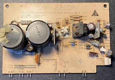

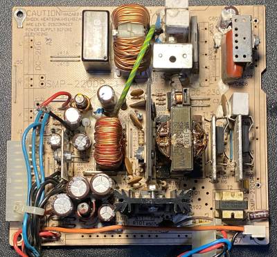

Power Supply (Delta SMP-220DB):
SMP-220DP-1:
Capacitor Value Size in mm
(length x dia)
C104, C105 3300μF 10V 36×13
C106 2200μF 10V 28×13
C107 1000μF 10V 20×10
C154, C156 1000μF 16V 28×10
C252, C807 470μF 35V 20×10
C253 220μF 16V 15×18
C513 10μF 50V 11×5
SMP-220DP:
(length x dia)
C1, C2 820μF 200V 40×30
C301 470μF 35V 20×10
C302 0.47μF 50V 11×5
C304 4.7μF 50V 11×5
C952 1μF 50V 11×5

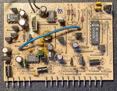

DC-267:
(length x dia)
C507 2.2μF 50V 11×5
C511 22μF 50V 11×5
C532, C601 10μF 50V 11×5
C655, C674 4.7μF 50V 11×5
C783 1μF 50V 11×5
C784 100μF 25V 11×7

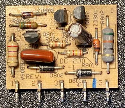

DC-230:
(length x dia)
C804 2.2μF 50V 11×5
